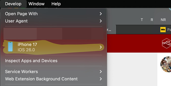

Have you tried debugging a page opened in Safari via on macos? Something like Chrome DevTools.
If you connect your iphone to a mac, you can open dev tools in safari on the mac for the iphone as well.
