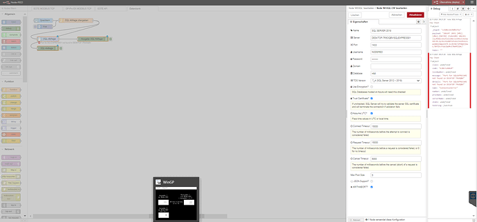

Here are my settings and the current error:
I can't find an approach (I guess I lack the expertise here) on how to find the error. Is it possible that it is the wrong port? I have found it on the Internet. Is it possible to read it in the SQL server? I also tried 127.0.0.1 - without success => same message.

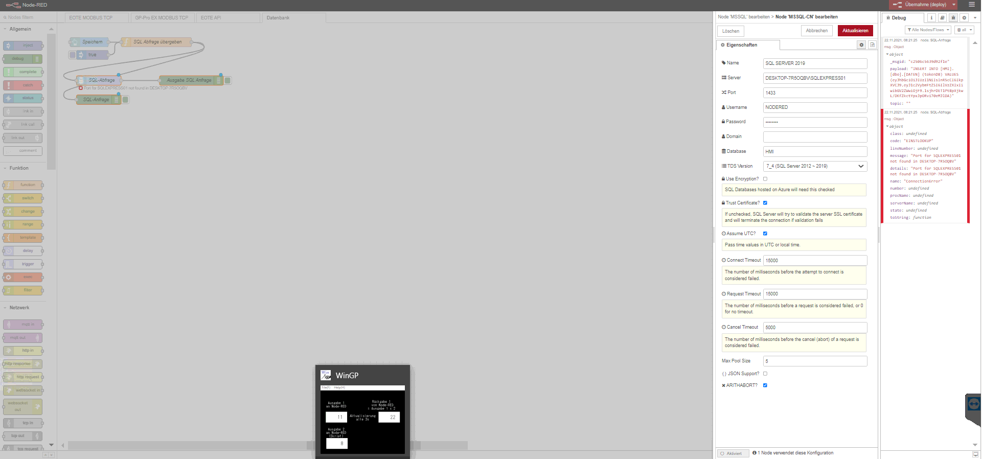

Then I restarted the server and retriggered my command. Now I get stuck at the next point. I have tried there now 2 hours around. Now the error comes:

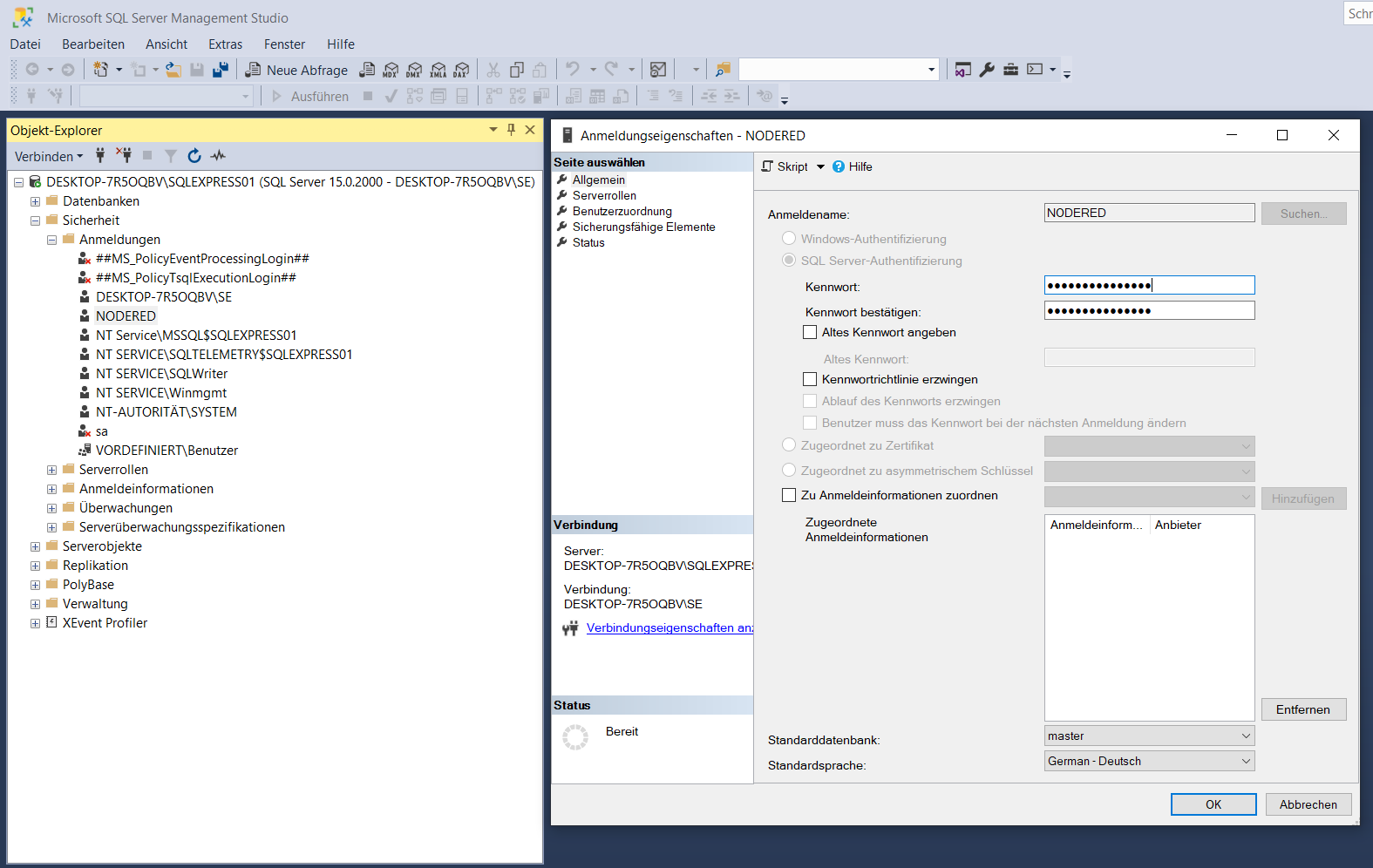

I created the user NODERED in the security of the SQL server:
Can it be that some other basic settings or basic parameters are missing?

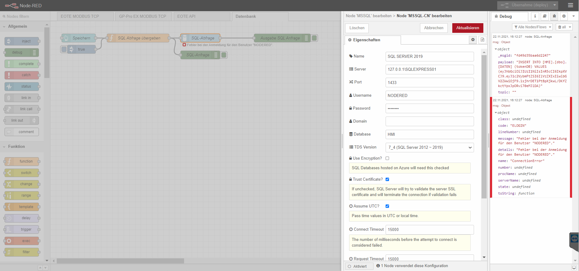

I did it, the error is gone. I deleted the user and then created a new one.
Seems to be related to the STRING content, now I have to see how to make a STRING - more STRING. If anyone knows the solution - am grateful for any help that shortens my search.
