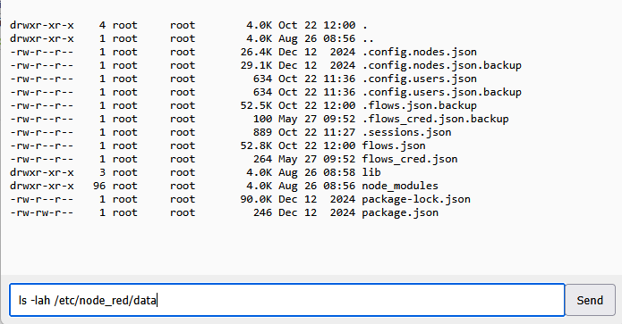

so i try to find the lora node via node-red
I (ChatGPT :see_no_evil_monkey: ) build a simple htmlpage with a websocket connection to look for node red folder and found it here:
The name of the lora package is this: node-red-contrib-node-library
But in the node_modules folder, there is no module node-red-contrib-node-library
I don't want to brick the device ( :money_with_wings:).
So i only want to read the filesystem, i don't want to invoke some risky commands.

/etc/node_red/data/
cat /etc/node_red/data/package.json
    "name": "node-red-project",
    "description": "A Node-RED Project",
    "version": "0.0.1",
    "private": true,
    "dependencies": {
        "node-red-contrib-aedes": "~0.13.0",
        "node-red-contrib-buffer-parser": "~3.2.2"
These are the nodes which i have manually installed
