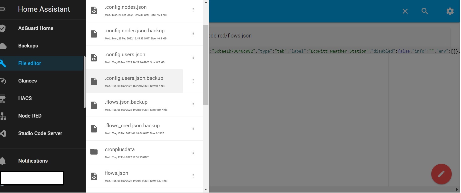

If you make a backup copy of your flows.json file then you could run a text editor on the original (a straight text editor, not a work processor) and do a search and replace. Then restart node-red. If it is a disaster then you can restore the orginal. In fact you no doubt take regular backups anyway so you may not even need to make an extra backup. Probably best anyway though. For the editor, on linux something like gedit would be fine.
I can use the File Editor in HA to access the Node-Red files.
Which file(s) am I looking for exactly to do the word replacement?
The flows file. Nomally it would be flows.json. I have no idea what HA calls it or where itputs it, but on a normal install it would be in your .node-red folder.
