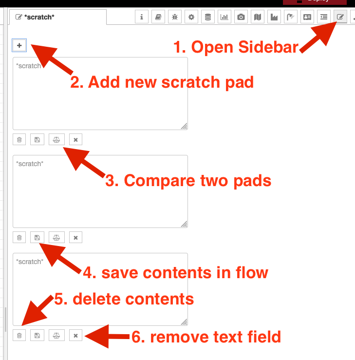

It is! I built myself a scratchpad node that gives me empty text fields where I can paste stuff temporarily (or save it in the flow). The node or better said plugin, lives in the sidebar so that it never closes.
I might publish it, I've only use it privately because I haven't seen a broader need and also because I didn't want to write documentation for it!
You can try it out over at the serverless Node-RED, it's included in that.
