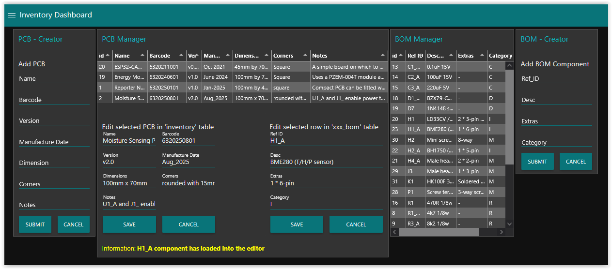

Just been building a Dashboard to interact with my MySQL database as inserting and editing the entries manually with Heidi was a PAIN !!
This dashboard allows me to create and manage a PCB (on the left-hand side) as well as insert/edit/delete components in the corresponding BOM table (on the right-hand side).
If there is sufficient interest I'll write a tutorial on how I built it (your feedback is appreciated).
