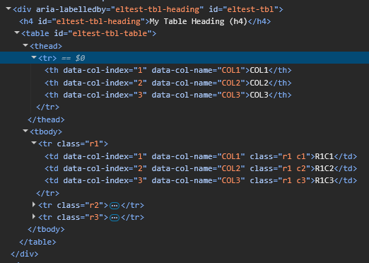

If you examine the created HTML, you will see how each row and each cell is identified:
(this from the element example provided by uibuilder)
You can also use the dev tools in your browser to copy a unique CSS selector to identify a row or, as in this example, an individual cell: #eltest-tbl-table .r1.c2. You can use that selector with the uib-update no-code node. Please try out the provided examples:
Noting that one of the inputs updates a specific cell, another adds a new row to the table. You can, of course, replace a whole row or remove it.
Also note that the actual output of a no-code node is low-code - which is simply a specific set of JSON in a message. You can examine the message and you will find it easy enough to manipulate yourself. Also useful if you ever want to cut out a node and create the message yourself. Perhaps to do something that the current nodes don't currently do. This is one of the key differences between uibuilder's no-/low-code nodes and the Dashboards. UIBUILDER's nodes create configuration data that mirrors HTML. So as you get more confident and knowledgeable, you can continue to build up anything you want. One of the key design principles of UIBUILDER is that it ENHANCES native HTML, CSS and the browser API's, you do not reach a complexity cliff as you commonly get to with Frameworks.

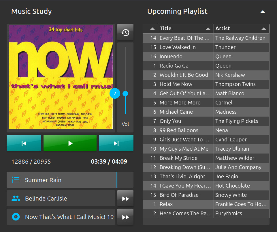

This is one of them, sized for mobile usage, it's a music controller.
