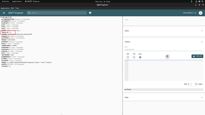

Yet, if I run MQTT Explorer it says that topic is empty.
Strange as it is published to that topic.

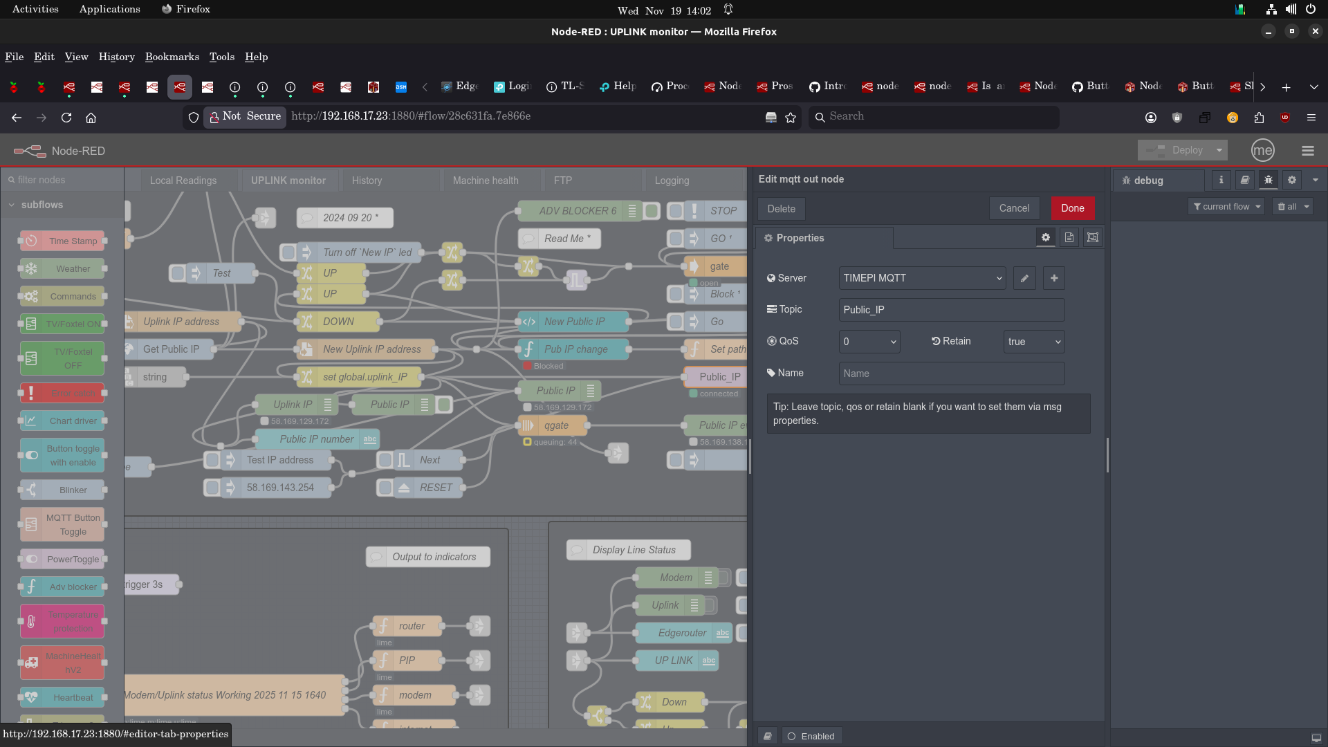

You can see the value it it goes to an MQTT out node.
The node's config:

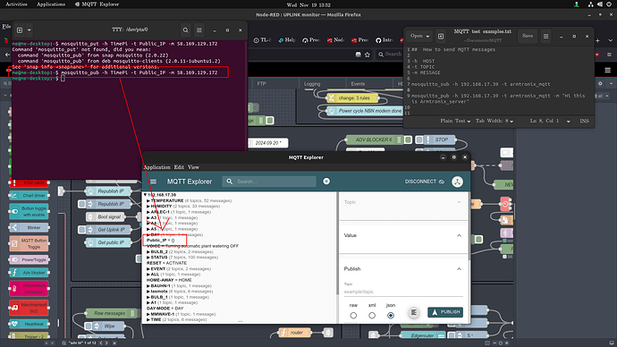

MQTT Explorer's take on things.
See how it is EMPTY .

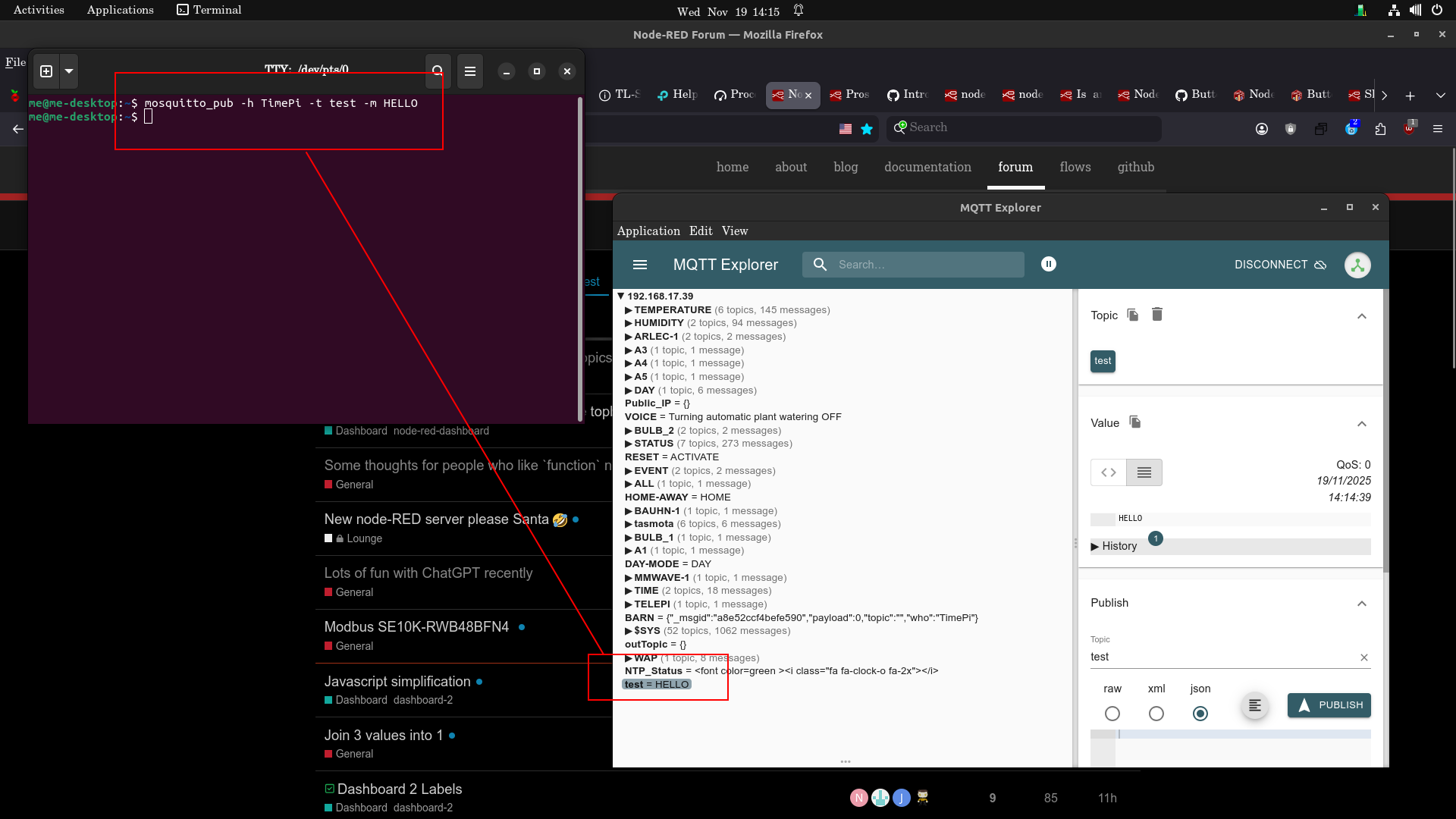

I test it from a CLI and it doesn't get set there either.

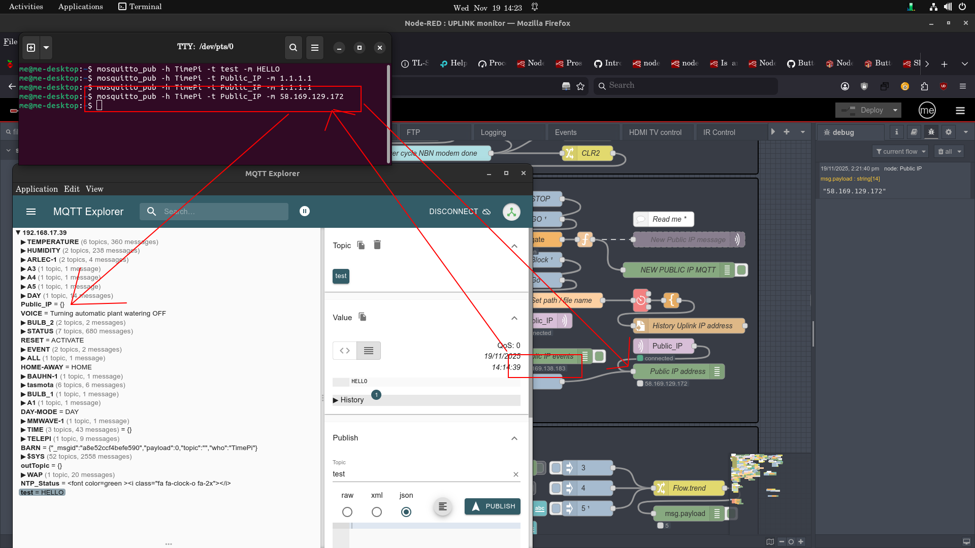

UPDATE:
Even more weird.

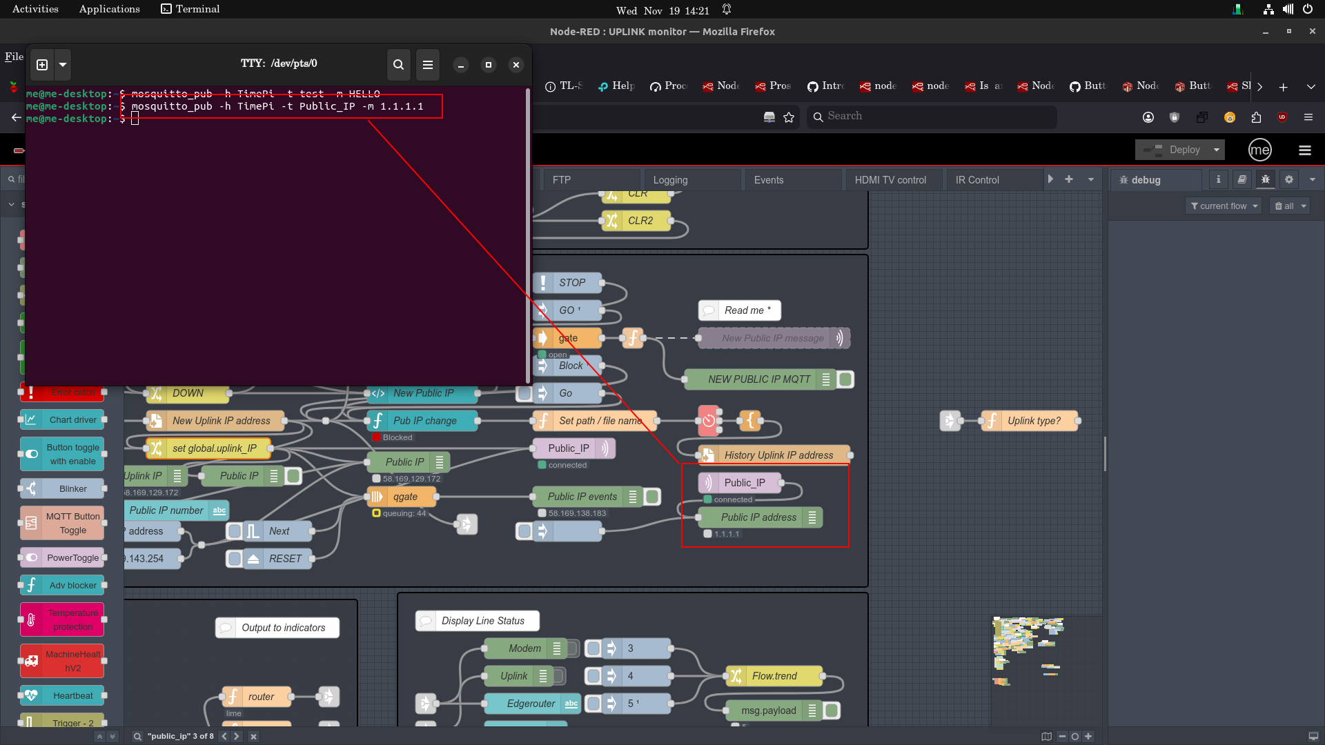

I set the IP address to 1.1.1.1 - just for the fun of it.
It is acknowledged in the MQTT in node.
And you can see the IP address in MQTT Explorer
But if I set it back to what it REALLY is - partly hidden but anyway.....
You can sort of see the real IP address. Anyway, I enter it and broadcast it from the CLI.
You can see how it is sent/received by the MQTT in node - as before.
But MQTT Explorer goes back to showing only {}
