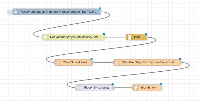

If you like to go for a workaround,
, this flow could work. :neutral_face:
-anita
