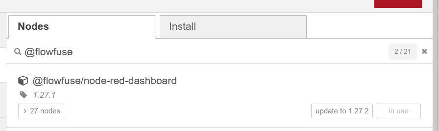

I notice that on the Nodes tab of Manage Palette, the LHS shows I have DB2 v1.27.1 and the RHS shows an update to 1.27.2 is available.
But on the Install tab, which I go to because it has the link to the nodes' page on flows.nodered.org, the LHS shows the latest version and the RHS has "Installed" with no reminder that this requires an update.
Can the Update to 1.27.2 button (or "Update from 1.27.1") be shown on this tab too?

Your two images each show a different version: the first shows that you have installed v1.27.1 and the second v1.27.2. If it's the same NR instance, that's not possible.
If, on the other hand, they are two separate NR instances, then I understand your FR.
Yeah why not :wink:
My two images show the two tabs in Manage Palette, on the same machine!.
The "Nodes" tab shows on the left the version I have installed, which is sometimes not up to date, and on the right it shows [if] there is a new version available.
I see no problem with this behaviour.
The "Install" tab shows on the left the current release version. I assume this is correct. On the right is "installed" as a greyed out button, which is a bit misleading because I may not have that exact version installed.
Maybe the "Install" tab does not have easy access to the installed version?
I see the same thing. The Nodes tab says that 1.27.1 is installed, and 1.27.2 is available. The Install tab says that 1.27.2 is the current version, and says that the node is installed. It does not realise that the version installed is actually 1.27.1, not 1.27.2

Actually, 'installed' just means that the palette has been installed, not that specific version.
That's very confusing, sorry, I forgot this behavior :sweat_smile:
The update button would be a good solution.
