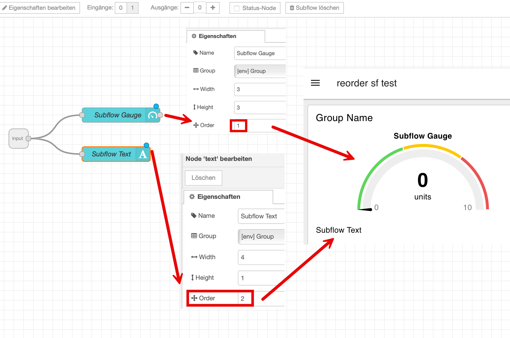

Your flow behaves as expected for me. (flowfuse dashboard 1.26)
I am not at my computer at the moment. Did it work with 0 and 1 as the order?
It defaults to 0 so I assumed 0 and 1 should be ok.
Ignore that. Having messed about with the numbers and deployed a few times it is now working with 0 and 1, so something odd is going on. Possibly to do with the fact that the subflow and nodes existed before I upgraded.
I will see if I can get back to a failing condition again.
