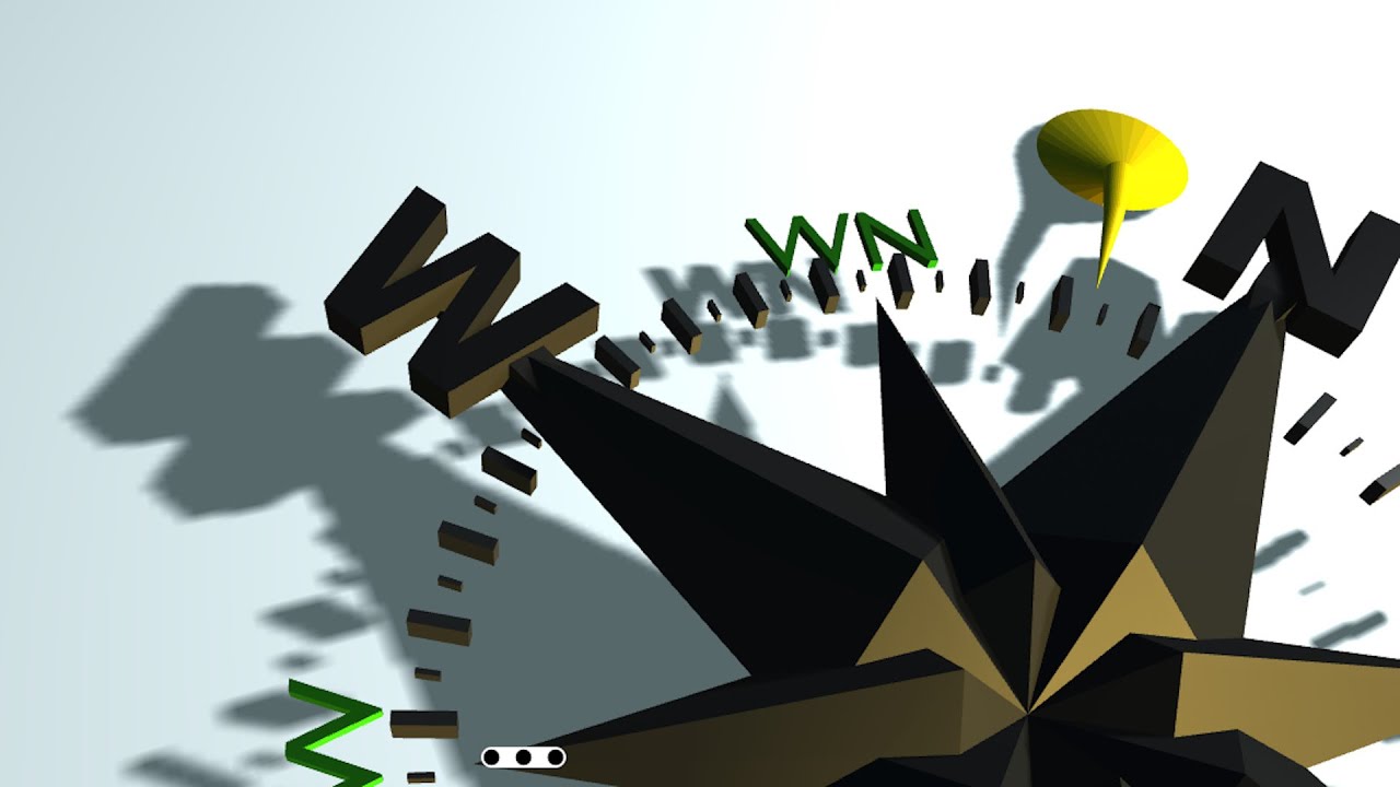

I will like to share with you one of my first releases of yss ver 0.1
Now chisel out from oiyshTerminal monstrosity it's free !
yss is something in a category of dashboard-ui but .svg, 3d object (.glb) and pure .html panels.
It will be a framework to have menu, Screens Manager, semi shaders to invert colors or night red-black.
Lot of examples :slight_smile:
You have data in node-red. Push them to link in node "ws_yss" and you will get msg in javascript in yss.
