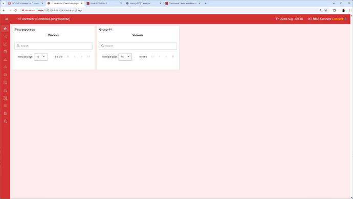

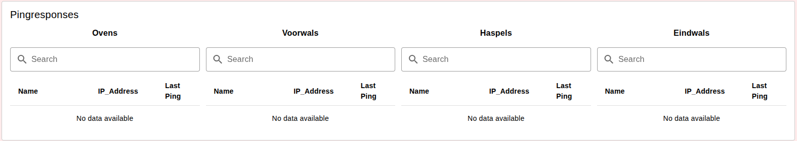

Dashboard 2 table searchbar huge
For some reason, my searchbars have variable size. Why is this? They should all be like the first one.
Since we have no idea how you have implemented the search bar it is impossible to say. Please export the search bar node and paste it in here.
I didn’t, it’s the default search toggle in the table node in dashboard 2.
This is the table:

OK, I have not used that, I will let a table expert answer.
What version of dashboard are you running?
Renders ok on @flowfuse/node-red-dashboard 1.24.2
Do you have any custom CSS templates?
Running 1.24.2
Am however running 4 tables side by side in the pingresponses group. First one works fine, the other 3 do not.

I do not believe so, i only use the default settings that dashboard2 provides.
That is ok for me
Upgrade to the latest version of the dashboard in case that makes a difference.
If that doesn't help then search (ctrl F) for ui-template to find an such nodes. Then check to see if any of them are of type CSS.
