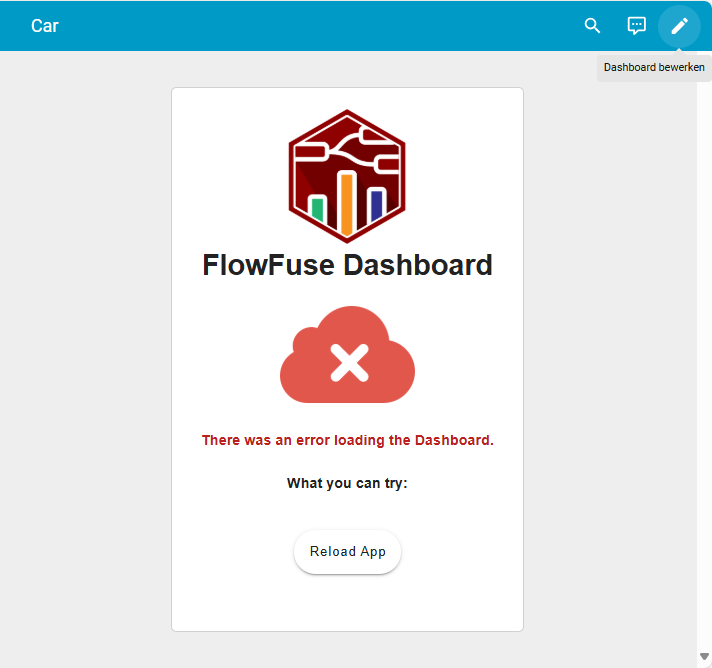

Dashboard error
I’m running node-red in Home Assistant. I’ve installed the pallet: @ flowfuse/node-red-dashboard
when I go to my dashboard x.x.x.x:1880/endpoint/dashboard/page1
I get below message:
the dashboard v1 just works on x.x.x.x:1880/endpoint/ui/
the logfile of the add-on gives me this:

It happened to me as well. The endpoint for dashboard-2 (../dashboard) is not defined by default, you need to define it (either create a new endpoint, or just expose the URL), which then allows to show dashboard-2.
Is this just when running with HA node-red plugin?
Yes. If you are editing & running your flows on Home Assistant's internal Node-red add-on, and want to use dashboard-2, you need to expose the dashboard-2 URL.
There are several ways to do it, easiest is to create a new Home Assistant dashboard (of type 'Web Page'), with the URL of the Node-red dashboard-2, e.g. x.x.x.x:1880/endpoint/dashboard.
This will allow you to access DB-2 from both within and outside of HA
Just ensuring there is nothing we can do here? Could I trouble you to open a PR against the online docs for Dashboard please? Maybe add it as a new “User Guide” on the left side of the docs too? Suspect this should be coming up a lot, and would be good to have an answer on the docs, and not just in the forums.
thanks this solved it! in my case: x.x.x.x/endpoint/dashboard/page1
