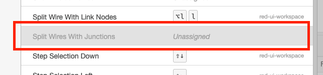

Just discovered this shortcut that isn't normally assigned:
Assign that with some keyboard shortcut. And then assign this to a keyboard shortcut
Screenshot 2025-12-08 at 22.39.44
And then it should be quick to disable wires.
Well, it will be quick to disable the wire. But you would still have to DEPLOY to get it applied.
Add a shortcut for the deploy action, so that's three shortcuts.
