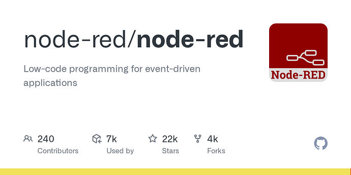

LLM Copilot has been trained on GitHub
node-red has a repo on github
Using a LLM for node-red will probably not work as intended
