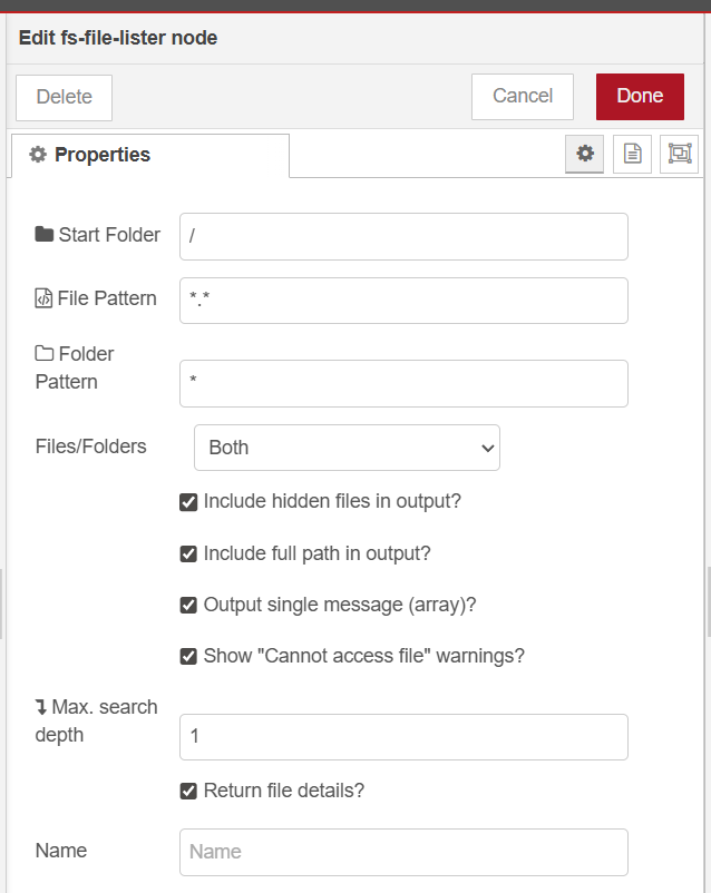

I used these settngs:

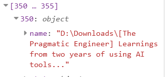

And got a LOT of entries back including from sub-folders:
Thank you mate, the trick is to put * on Folder pattern instead of \
It would be lovely to add a note on it as “use * to include all subfolders”, or let user specify a path and add down an option “search also in all subfolders”.
Thank you for your kind support!
Isn’t that just standard glob?
Yes, it uses glob under the covers. :smiley:
