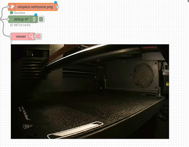

I'm currently on NR 4.1.1 and node v20.18.1
Installed your node on my main PC and seems to work fine (using put)
![scene](upload://5aBtTbOlUUUl91HiaAto3AD4gqH.jpeg)
[edit] tried get on simplesi.net/last.txt (latest cheerlights colour) and that worked fine as well :slight_smile:
