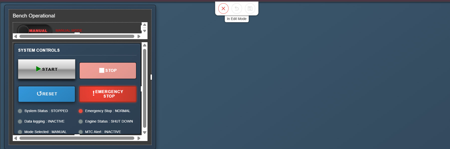

Hai, anyone experience the save button "in edit mode" dashboard 2.0 disablled, after doing some drag the save button disabled. I cannot
save my grid arrangement

Please open the dashboard edit page and then open the developer tools console in the browser (this is F12 for several browsers) then change the size of one of the widgets and show us what you see in the developer console.
hai Colin,yes i'm using dashboard (1.30.0) , i think it is browser issue as you explained. okay i will give it a try . thank a lot for the insight.
After several trial , it is caused by the UI is overflowing more than the dashboard can handle, but by adding a spacer the save button appear , just little trick to make the save button normal again .
