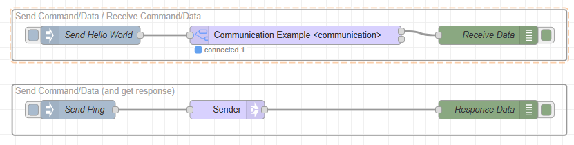

I am trying to get a response from the UIBuilder instance, after using a injection node to a sender node to a debug node.
I have set the originator in the response message but I am not getting the hang of it. Receiving messages from front-end to node-red is no issue.
I just would like to see a good example of how to set up the response message for the sender node.

Everything in the screenshot works, except receiving the response data in the response data debug node. Which is where I am trying to return the Send Ping injection with a Pong:

Hi and thank you and @Paul-Reed for the quick response!
I have tried both methods of setting the originator and set it message specific.
I am however having trouble receiving this particulair message. I do not seem to realise anything that is off. I confirmed the originator is set properly and simular as the original message.
See screenshot of console.log:
I have also shared my simple test flow with my current code. I believe it should be copy’able.

Let me try out your flow. It is perfectly possible that I've broken the feature somewhere along the way as I rarely use it myself. :smiley:
No worries! I wouldnt be surprised if I messed up thing myself :slight_smile:
Thank you for the bizarre quick responses though!
OK, I have reproduced the same issue - it's not you!
