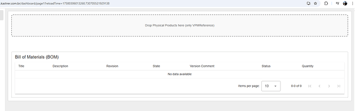

Hi Everyone,
I am trying to load a specific dashboard as a widget on my Platform application.
It functions as a standalone page; however, it does not work as a widget.

I installed node-red from a its dockerhub image available there.
As you can see, the dashboard works as a standalone component.
It is protected by https via cloudflare and ngnix.

And here is the curl that I did for testing it before submitting this topic.
 GKR14    ~  master ≢  ?63   0ms⠀   curl -I https://node8.kastner.com.br/dashboard/css/app.css 14:28:17 
HTTP/1.1 200 OK
Date: Tue, 16 Sep 2025 17:28:24 GMT
Content-Type: text/html; charset=UTF-8
Connection: keep-alive
accept-ranges: bytes
access-control-allow-headers: Origin, X-Requested-With, Content-Type, Accept, Authorization
access-control-allow-methods: GET, POST, PUT, DELETE, OPTIONS
access-control-allow-origin: *
Cache-Control: max-age=43200
content-security-policy: frame-ancestors *
content-security-policy: frame-ancestors *;
Report-To: {"group":"cf-nel","max_age":604800,"endpoints":[{"url":"https://a.nel.cloudflare.com/report/v4?s=CYtXwr1R%2Ft4gzN8KHxa%2BceHVnhLMbn3bWagfln%2FY3a%2Bjh4LisVIujX79wIn4PP2ytO%2Fp2JRdgAPBsH6GB6%2BfbZ%2BZliqDZ5NpZt2ux8u6g0flO2kR"}]}
expires: Wed, 17 Sep 2025 01:31:14 GMT
last-modified: Mon, 15 Sep 2025 12:57:21 GMT
Server: cloudflare
x-content-type-options: nosniff
x-frame-options: ALLOWALL
x-xss-protection: 0
Nel: {"report_to":"cf-nel","success_fraction":0.0,"max_age":604800}
Age: 14230
cf-cache-status: HIT
Vary: accept-encoding
CF-RAY: 98021481998d88fb-GRU
alt-svc: h3=":443"; ma=86400
Here is the error from my web application
