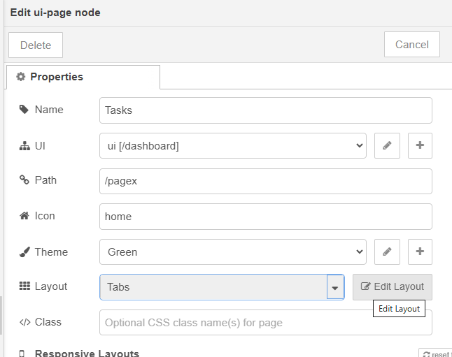

You can set the page layout to 'Tabs'
That is assuming that you are using the newer dashboard @flowfuse/node-red-dashboard.
Here is the document section on tab layouts for more information: Layout: Tabs | Node-RED Dashboard 2.0
