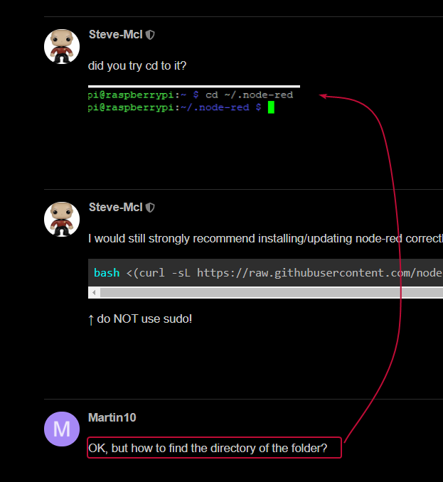

did you try cd to it?

OK, but how to find the directory of the folder?
Like i showed you...
cd ~/.node-red
Yes, i did this, but I'm used to window, so i wish to see the whole path
pwd
It was hidden, that's why i can't see it
That what the . means (e.g. .hidden-folder)
