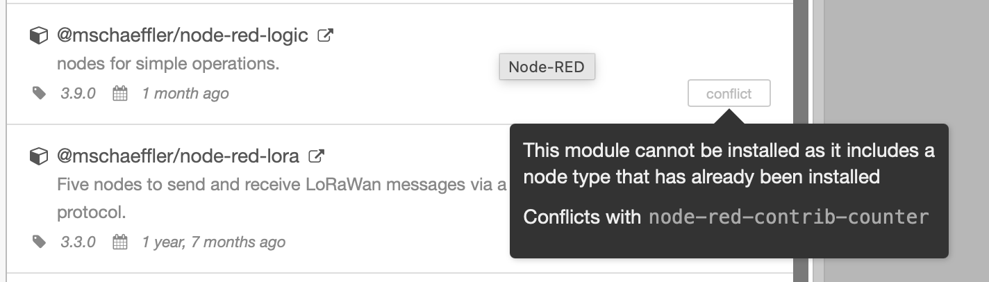

I want to install a package (@mschaeffler/node-red-logic) in Node-Red (Home Assistant) via Manage palette. Instead of the Install button there is a field written conflict.
But I can't delete the node (node-red-contrib-counter) that poses a problem because it doesn't display the uninstall button...
How can I solve this problem?

Have you tried removing all counter nodes and then reloading the editor?
Hi GogoVega
I have disabled the node.I don't use it.
The uninstall button is not present.
If you have access to a terminal session on the node-red server, you can remove it manually using npm. Don't forget to restart node-red and reload the Editor afterwards.
Access to the command line of a container(NR) is disabled by default in HAOS. The easiest way to get there is to install this version of portainer. From the gui browse to the nr container and choose console.
